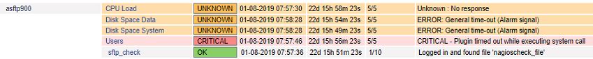

I have been getting this "error general time-out (alarm signal)" with few servers. This is just one server example. I tried to google to find the solution but nothing work.

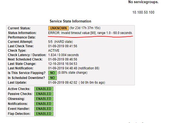

I made the changes whatever you recommended but it didn't work out. It threw error "Invalid timeout value...." you can see in the picture
Posts: 9190
Re: error general time-out (alarm signal)
The nmap command shows that the UDP port 161 is closed so that is not good.
Check that server and verify that it is running SNMP.
The timeout error for the plugin is caused by a too large of value for the -t option, set it to 60 seconds and that will fix that.
