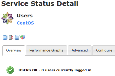

Observe Users Service
Open a web page to http://10.25.5.20/nagiosxi
In the Search field at the top type:
CentOS
Click the Users service
It should look like the following picture:
Click the Schedule a forced immediate check link
Wait while it executes the check and the screen updates, it will go into an OK state
Open a web page to http://10.25.5.30/nagiosxi
SNMP Traps
Click the SNMP Traps service
You will see a picture similar to below:
Now you can see the SNMP Traps service on the SNMP Receiving server has updated
There is quite a bit of information there, you will learn in Part 2 of this tutorial on how to optimize this
The key information here is "CentOS Users 0 OK – 0 users currently logged in"
Now SSH back into the CentOS server and force an immediate check on the Users service on the SNMP Sending server
This will enter a WARNING state again and will send another trap. It will look like the picture below:

Now send a trap and see how the service appears as in Nagios XI.
Establish an SSH session to your CentOS server
Minimize the SSH session as we only need it to establish a user login
CentOS
Wait while it executes the check and the screen updates, it will go into a warning state
Click the Admin menu heading

Return to the SENDING SNMP server and Schedule a forced immediate check for the Users service
Return to the RECEIVING SNMP server and the SNMP Trap - Users service will now be updated like the picture below:
This reflects exactly what appears on the sending server (except we've pre-pended the service name with SNMP Trap  -)
CentOS
Here you will see something similar to the picture below:
Now you have all the SNMP Trap services receiving data for the CentOS host
