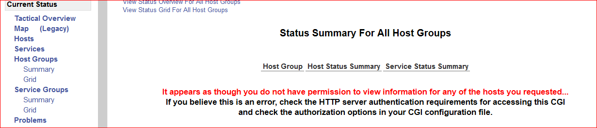

I've seen some similar posts on this subject but haven't located a post that works for me. When I try to view the Service Overview for All Hosts, Status Summary for all hosts or Status Grid for all hosts, I get a permissions error. I'm running Nagios Core 4.1.1 on a CentOS 4.9 server. Any suggestions on how to fix this? I've attached a screen shot.
Thanks in advance.
Screenshot of error I'm seeing.

Are you logged in as an administrator?
Can you post the contents of your /usr/local/nagios/etc/cgi.cfg file here?

Re: Can't view some info on Nagios web interface
Is this a fresh install or has it worked in the past?
Also, what user are you logged in as?
Can you run the following commands and reply back with the output -
tail -n25 /var/log/httpd/error_log
tail -n25 /var/log/httpd/access_log

I'm logged on the interface as nagiosadmin. This is an upgrade from 4.0.8 and to be honest, I don't recall if it worked in the past or not, since I usually just display "hosts".
